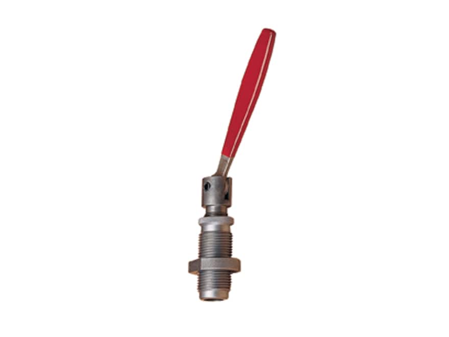

Get the Hornady press mounted bullet puller with collets. You can pull a bullet in about 5 seconds and be onto the next. Just a matter of raising the press ram til the bullet is in the collet pushing down on the bullet puller handle 45 degrees and lowering the ram. then lifting up on the handle 45 degrees and grabbing the bullet. Ive tried about every method and this one I find to be the quickest and easiest. I believe its called the Hornady Cam Lock Bullet puller.
Changing to a different size of collet only takes about 30 seconds. So if you have multiple calibers you need to pull. Changing collets is very quick and easy. This tool is money well spent and will last a lifetime.
Here's the bullet puller
Here are the collets
That is all you need to get up and running.
I have 2 bullet pullers, a pair of electrician pliers and the Hornady Cam-Lock as mentioned above.
If the bullet is going to be scrapped, the pliers are the easiest and fastest to use.
I really like the Hornady Cam-Lock Bullet Puller the best. It does take a little getting use to as far as setting the tension just right on the collet. If it is too tight, you damage the bullet beyond use. Too loose and it slips off the bullet. When the tension is perfect, you can run through a lot of bullets in a short time period. Bullets come out perfect and the powder is also ready to reuse.
