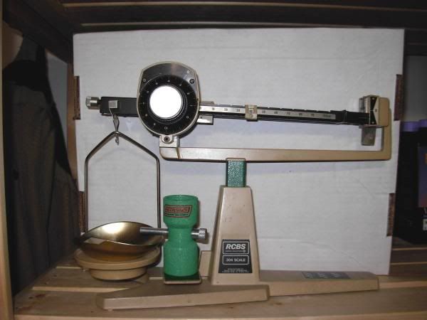

Another top of the range scale is the RCBS 304, this is a large upright scale, it's very accurate but I don't think its still made.

and the 304

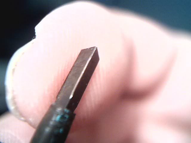

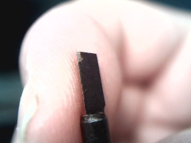

Typical damage to knife edges
Chipped Blunt
