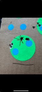

Old thread I know.
I’ve read a lot of people are jumping these 80.5 full bore bullets within .005”. I bought several boxes of these without any cartridge/gun in mind. I figured I’d end up finding something for them as I’ve put together a few guns this past year all in 22 cal and the latest is a 22 GT for a heavier night vision setup.
I watched a YouTube video (I know I know) and just guessed on charge weight after seeing what did ok for somebody else.
H4350
CCI 450 primer
Berger 80.5 Full bore
New Alpha brass
.004” jump
.222” 21st century mandrel
I loaded three at 35.4 and three at 35.8 and first three shots including cold bore (35.4gr) went into one tight group @ 1:00 on target, with no vertical. The next had a significant POI shift but still a pretty tight group @9:00 on target. I guessed at .004” jump.
I loaded for a ladder test (haven’t shot yet) but weather was bad and I only had 15-20 minutes but looks good so far to me.
3-35.4gr 1-2,966 cold bore, 2-2,954, 3-2,947
3-35.8 1-forgot to reset Garmin, 2-2,969, 3-2,984
Bartlein 7.5 T .218 bore @ 20” 85 rounds on barrel.
The shot @ 12:00 is from yesterday and sighting in a 80 eld-m load and this was the only semi clear spot on the target..
I was wondering if I might have made a mistake on these 80.5s but got lucky. We’ll see about getting a final load worked up. Thought I’d share my results in case anybody else runs into this… .004” jump was a lucky guess today!
