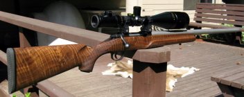

So far Berger's 35 gr Match HP with 26 gr of H322 works best in my Cooper 21 Varmint Extreme 20 Tactical, 24" SSteel, 1-12" twist. I've had 5 shot groups down to 0.23 MOA, averaging arount 0.38. Day to day, this load is the most consistant in location and size of group. Velocity is just over 4000 fps.
