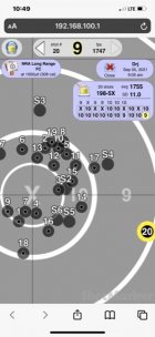

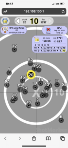

I do tip 195’s and that’s it, so my targets below do represent about the least bullet prep possible.
