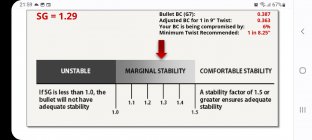

Wanting to try these in my 28 nosler I had built. My barrel is a 1-9 twist. Has anyone tried these in a 1-9 and did they stabilize?? Thanks
The chart below is from the Berger Stability Calculator. You may get round hole and decent groups but your BC is suffering.
Another consideration is the chamber itself. These bullets can require a longer throat and/or freebore to accommodate these longer bullets. They are not plug and play.

Yes sir I plugged that in to with my elevation and came up with this. My chamber is .225 freebore if I remember right 60720F8C-C10E-41D5-B06E-34E2006E628F.png

A 1:9 usually works. The only time I had a 1:9 NOT work, was on a cold, damp and humid winter day near sea level outside of Houston. Those conditions combined for the densest air I have shot a .284 in, and the bullets were unstable and shot as big as 4-5 moa at 1,000.
Agree above, that BC may also suffer from yaw at the stability margins before conspicuously wandering off target.

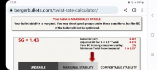

Yes sir I plugged that in to with my elevation and came up with this. My chamber is .225 freebore if I remember right View attachment 1385623
If you came up with a 1.43 SG. the bullet is stable. BUT you have compromised the BC of the bullet so you may see more effect on the bullet at 600 yards and out by the wind, ETC due to the loss of BC. Also be sure to use the compromised BC G7 number when doing any ballistic charting.
Those figures were mine based on my new 1 in 8.50t bartlein and the twist rate calculator suggests I was losing 2% of the bullets bc and it recommended a 1 in 8.25 twist for the 195s..
I agree on 1.43 will be stable and shoot well..
Enter the figures in for a 1 in 9 and it will be a much lower figure..
