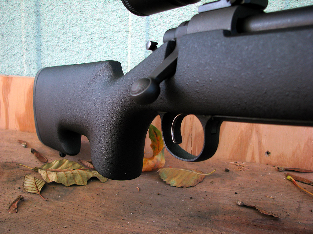

I love my B&C stock on my SPS 700.
5 shot groups shrank about a 1/4 inch on average by just swapping out the factory tupper ware stock.

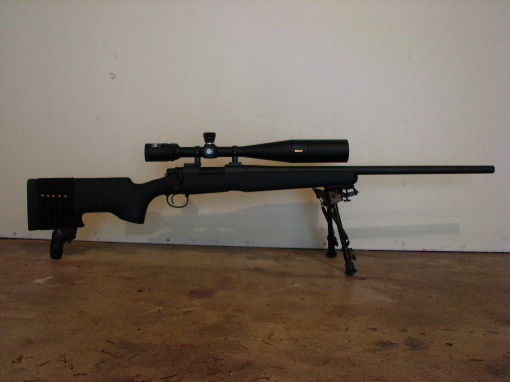

I just bought a Bell & Carlson Tactical/Varmint stock for my Rem. 700. It is a well made stock at a decent price. It has the adjustable chhekpiece, buttstock and sling swivel rail. I would highly recommend this stock to anyone who wants a great stock that is a bit cheaper than some of the others.
