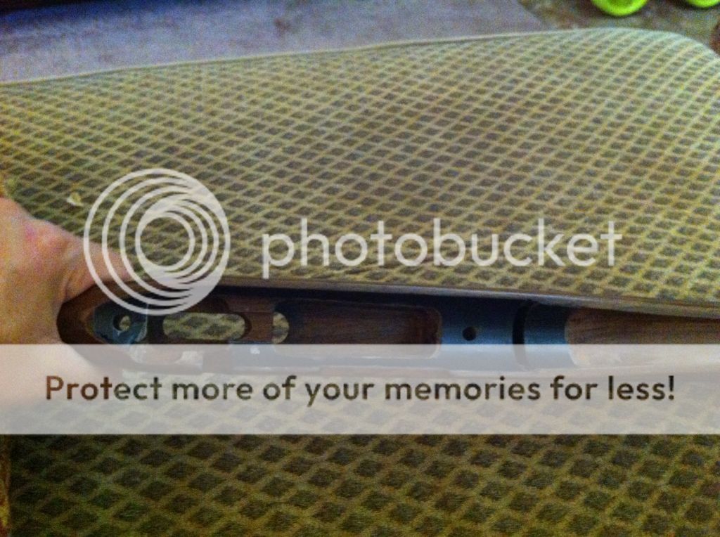

I've got a wood stocked adl Remington 700 I want to pillar bed. My question is on the front pillar that has the escutcheon how deep do I drill the enlarged hole. Do I keep the escutcheon in place and drill from the top down to the top of the escutcheon? If I enlarge the hole completely, the escutcheon will no loner fit.

Thanks allot preacher. I just skim bed it like I've always done but I did wrap the barrel in .020 thick tape and bed 1/2 of the barrel channel for some added strength. I will seal the rest of the barrel channel and the but stock to help reduce shrink/swell. Will see how it goes, devcon should impede movement considerably. Before I removed the old bedding it had .150 of deflection so anything I can do should help.

Popped it out today. Has around .001 deflection when tightening and loosening the screws. It's floated to the lug, I just added the pad because there was a huge gouge in the barrel channel ahead of the lug from the previous owners botched bedding attempt. I will check it after hunting season and it's been through it's paces and see if the deflection has changed.
