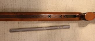

actually, I think I found out why they did not recommend pillar bedding. after removing the rail, The stock has a steel insert around the front screw. going to make it harder to bed.
That's a bedding bolt bushing. It's removable. Anschutz Match 54 single shot rifles have them and many shooters pillar and glass bed them. It may be advisable to have someone with experience do the job.
