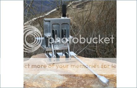

I am considering start reloading at the range and would like to have a press that would fit my needs on reloading 6mmBR, .30BR and .308win calibers.
The best setup press I saw is this Italian made: http://www.bcmeuropearms.it/presse_eng.html
Two 7/8-14 Die station and one Straight Die,Wilson) station is everything I ever need.

On the last hours I received some emails and PM about those press and one in particular was eye opening...
A gentleman from US who has the BCM press took a photo of the BCM press and a Hood press, side by side. And the BCM press is a BIG press!!!
It seems that it is not the best option to bring at the range as it is a big press... and very expensive: about 350 Euros in Italy. After shipping to US the price will be closer of U$700,00.

I've hauled the former to the range before, many times. A BCM would never leave my bench.
