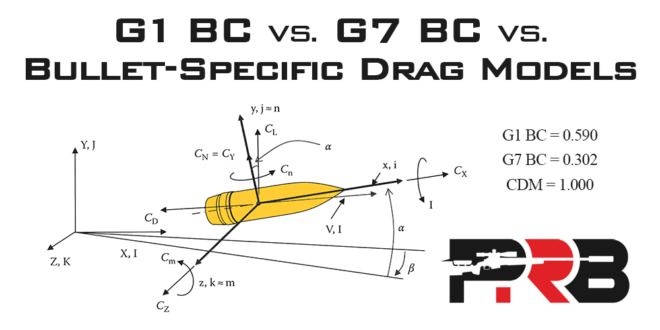

Using data in Litz book over a wide range of bullet calibers, designs, and weights there is a perfect correlation between G1 and G7 meaning the characterization is not different for the two methods. Of course the flight models are different with a
resulting impact on ballistics.
A fixed numerical relationship between G1 BC and G7 BC is not accurate, G1 BC varies a lot with respect to the bullet velocity as it flies down the range, the G7 BC is almost stable after the mid-range,
Using G7 BC drag model would predict the trajectory more accurately than the G1 BC model all the way down to 1.2 Mach
Bryan Litz

I agree completely that the models provide different trajectories. But given a perfect correlation, how would G7 tell one anything different than G1? In other words if I know G1 I can calculate G7 so the two characterizations do not include any unique information vs each other.

A bullet's weight has already been figured into its BC (i.e. BC = (weight/7000)/(caliber*2 x i) where i= the form factor of the bullet). If you divide bullet BC by the weight of the bullet, which has already been factored into the BC calculation, you are simply looking at a multiple of 1/i for a specific caliber, because the caliber and 7000 values are both constants (i.e. BC/W = (1/7000)/(caliber*2 x i). I don't see how this is really any more useful for the average shooter than the original BC value. If you just want to look at the form factor, Berger provides this value for their bullets, or you can buy a copy of "Ballistic Performance of Rifle Bullets" by Bryan Litz, which contains form factor values for a fairly wide range of bullets from other manufacturers. Otherwise, how does dividing the BC by bullet weight, which is a fixed value and already part of the BC, really tell you anything more than the BC itself?
Regarding the topic of "fixed value" relationship between G1 and G7 BCs, again, it all boils down to the form factor. If one divides the average G7 BC for a given bullet by its average G1 BC using actual measured BC values such as are found in Bryan Litz's book, what they will find is that a value of fairly close to 0.51 will be obtained for a surprisingly wide range of bullets. I believe that turns out to be the relationship between the G1 and G7 form factors, which is not surprising because in the formula listed above to calculate BC, all the other variables will be identical for a single bullet except the two different form factors, and thus will drop out of the equation, leaving only the ratio of the G1 and G7 form factors. So yes, there is a "fixed" relationship between the G1 and G7 BC values for a given bullet, as described in the BC equation. The difficulty in directly comparing the two lies in that BCs derived using the G1 method need to be "velocity banded" to better fit the actual drag curve across the typical velocity range. This is because the G1 form factor is a relatively poor representation of the actual shape of the bullets most of us are using, so the BC needs to be velocity banded in order for the actual data to fit. The G7 BC is much less sensitive to velocity than the G1 BC because the G7 form factor is a much better representation of the shape of the bullets we typically use in precision shooting.
