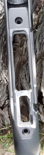

These are still pretty new so I thought some one may want to see how they turn out. This rifle wasn't meant to be ultralight, just a medium weight that carries and shoots well. Heavy enough to not need a brake in a medium caliber good for just about anything with in reasonable range.
These actions are really cool, aluminum body with a steel insert like a Panda. The teflon coating makes them smoother than a steel action in my opinion. The timing is spot on right out of the box with the Jewell, and there is plenty of firing pin fall and energy. They come inletted for a cfe-9 Wyatts box but I made a spacer and used a standard length cfe box for the saum case. After some tuning of the box and spring it feeds like butter. I bedded it into a McMillan game warden max (now discontinued), its a carbon shell with a version of edge fill that will take any caliber. It weighed in about 28 oz. These actions do have a lot of places to trap air pockets, so they are a little trickier to bed. I used a #5 Lilja 8 twist 3 groove barrel cut to 26". The bullet of choice is the 175 LRAB which should need at least an 8.5 twist to really shoot its best. Overall it weighed in right at 7.5 pounds. DSC_0120.JPGDSC_0122.JPGDSC_0123.JPGDSC_0124.JPGDSC_0126.JPGDSC_0127.JPG

That would definitely be really hard to keep air pockets out of that area where the top of the screw thread post meets the flat bottom of the action. Great job on the bedding.

Something I’ve been wondering about on these actions and others similar are why the posts where the action screws go? I was taught (which may be wrong) that any parallel opposing surfaces need to be relieved in bedding. If you have a recoil lug and two more posts that seems like a lot of extra real estate to bed that could cause stress?? Similar to why you’d tape off or relieve the back of the tang on a BR action? Just trying to be educated.

The posts are there to give more thread engagement since your threading into aluminum. I have seen nothing negative about bedding parts of an action like that. Actions with an xp cut have opposing surfaces, Neuvos have 2 square cuts similar to an xp cut, Stiller vipers had a course fly cut along the entire length of the action that locked into the bedding the whole length of the action. There are many examples of actions that do have more than one registering surface that hold records. In fact a couple current agg records in lr br are held by such a set up. One of the most consistent rifles I have seen was a Panda with 2 recoil surfaces. You would be doing no harm by taping off all those surfaces but consider the friction between the bedding and action body where the screw goes through. If I relieved around that boss, what would I achieve? Its not like its going to move so long as the screw is tight. Mentally I would prefer a single surface, but in reality I cant argue with what has worked.
