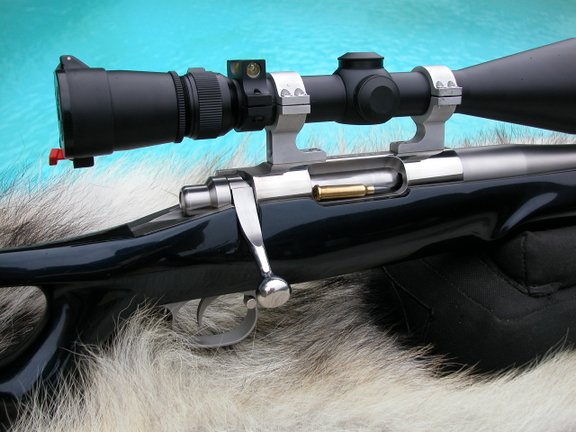

The Sako or M-16 type extractors also give better results than the slide gate style when you need a little fudge factor. Isn't that what is shown in the above pictures?
That is the common slide gate extractor used on custom actions almost exclusively until the last few years. I don't have a Farley in Hornet but have one, and a couple of Nesikas, in 223 bf. Have one Nesika T in Hornet that has been opened slightly to accommodate M1 Carbine brass for the current 22 Spitfire. They are all wonderful actions, so smooth.

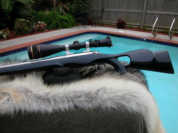

I like the extractor on the Farley Firefly better...although you'll play heck finding one. I only know of two with Hornet bolt faces that were built years ago...and I know who owns the other one.;):) A couple of pictures of a Farley Firefly coned nose Hornet bolt. The extractor is a small ball bearing and coil spring set-up. Works extremely well. 7315br
