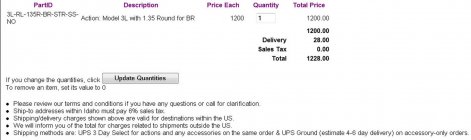

The attachment below shows the part descriptiion for what you want. This is assuming that you want a Right BOLT/ Left PORT.
3L - 3 lug action
RL - Right BOLT/Left PORT
135R - 1.35" Round
BR - BR bolt face
STR-Straight fluting
SS - Stainless steel
NO - No ejector
Hope this helps.
