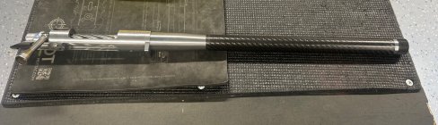

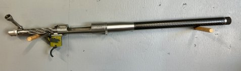

I have some local carbon wrapped barrels I cut down all the time, just did a 16” 7 Saum the other day. On this brand the smaller calibers .264 and below were around a .5” barrel under the carbon, and the larger calibers were close to .625”
Just like you stated, I thread the end about .875 and epoxy or red lock tite a bushing on to shoulder against the carbon and set back up for muzzle threads.
Use a vacuum right next to the carbon fiber when turning it off, it’s nasty stuff makes your arms itch and you certainly don’t want to breathe it.

Customer was going short barrel to run suppressed all the time, shot at my range and it was okay. However little more smoke was coming out of the suppressor after firing then normal.
