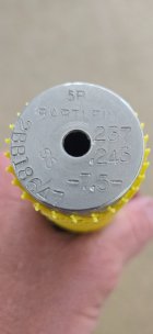

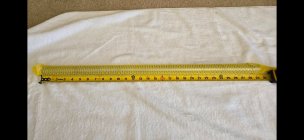

Selling a new Bartlein MOD400-BB barrel in 6mm 1-7.5 twist. The blank is 29" long and is a straight 1.250" taper. Asking $550 shipped.
