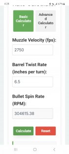

Valkyrie is what, 2600 from a 24", Nosler might be 2700. If barrel length was 28-30 [match rifle], you might get 100fps more?
Is 1:7 enough? I know in a 223 Rem it is not. Really need 1:6.5.
But at say 2750-2800 fps, i worry about blowing up bullets.

7 twist up to 3100 fps. 300k terminal spin is right at 3000 fps.

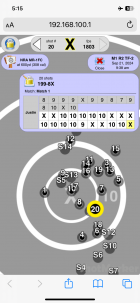

My 7 twist 22 Creedmoor hasn’t had issues with the 90’s, but the 95’s it has had some issues. My next barrel will be 1-7.5 or 1-8. I have to run the 95’s at about 2800 or slower to ensure they all register on the e target. Or it could be the etarget?…….
