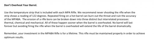

I see a temp for outside barrel temp, 125 F guideline, has been mentioned. When temping toward the crown does barrel dimension matter? What could the bore temp be from leade and then down the barrel ? At what internal temp does damage begin? Does this matter or should we be content with external temperature? Thanks
BTW, 140F is about as hot as you can stand to touch for more than a few seconds with your fingers. So a temp strip or pyrometer is not really needed. Just reach up and carefully touch the barrel in front of the chamber.
If it burns your fingers quickly, you should stop and let the barrel cool, or use the barrel cooler. I do this in fclass competition today. Works well.
I dont care about the temperature elsewhere on the barrel because the heat cracks seen with the borescope, usually form at the first 0”-6” just in front of the chamber.

I have a hard time believing it matters much. My barrels have always shot well regardless of their temperature (within reasonable limits, obviously, but 30 shot f class strings aren't an issue). And I don't think that the barrel is going wear materially more if it's hot - the gases are already in thousands of degrees. What's another 100 going to matter?
I would be curious to know the inside vs outside temps. Surely someone has measured this. The outside is going to lag significantly behind the inside and never reach the same heights as the throat.
