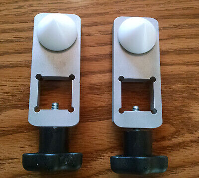

This guy on Ebay sells these barrel spinners, Actually looks decent. You could make one pretty easy, But in all reality I'm probably just going to buy one from him. It doesn't include the 1 inch square tubing, But That's something I have lot's of laying around.
Those are pretty expensive.
My only comment is that the delrin cones are super short. They should be an inch longer so you can re turn them several times
