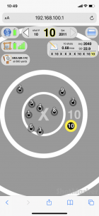

It’s taken awhile but I finally had the 6.5x47 barrel cut but had the problem of finding Berger 140 Hybrids to shoot. Finally got some and used a load of 36.0 grains of Varget seated at 24,000ths off. Could not get the heavier loads to group very well but shot the attached two 10-shot groups with winds of 5-6 mph with gusts of 10-12, left to right. Got some developing to do but pretty good scores for F-Class. As shown on the Shotmarker targets, the distance was 600 yards.
Again, thank you for your input. 2362447B-562E-4624-B7D3-007D7198BBD5.pngB477D26F-9D3F-418C-B282-DBD23F3E59D0.png
