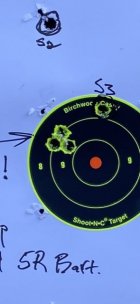

Frank’s regular stainless 5R barrel shot me this three shot group at 600 yards this week from a .284. Yes, they are the ones offering harder steel, too.
