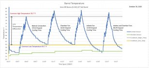

Decided to compare a couple of forced-air barrel cooling methods.
I used a self-adhesive thermocouple sensor adhered to the left side of the chamber, this is a K-Type sensor with sufficient accuracy for the task at hand, the sensor was connected through an interface to a laptop PC, readings were logged each second over a two hour shooting session :

The control was to let the barrel cool naturally, then the chamber fan, then the jobsite fan, then both fans. I selected a high temperature and low temperature common to all methods; in other words, they all start at the same-ish high temp and cool to the same-ish low temp, within 1/2 a degree.
The results shown below indicate the barrel took about 30 minutes to cool naturally, 19 minutes with the chamber fan, 10 minutes with the jobsite fan, and 8.5 minutes with both fans:

Where did you place the job site fan in relation to the barrel? Thanks for the data!
When testing the jobsite fan only, it's placed on the right side of the rifle adjacent to the fully opened bolt, it roughly faces towards the barrel's muzzle so the airflow is into the chamber and along the barrel lengthwise.
When testing the jobsite + the chamber fans, the jobsite fan is on the left side of the action, facing towards the muzzle so the airflow is along the barrel lengthwise.
