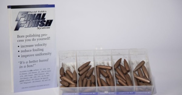

A factory barrel very likely does need to be "broke in". IMHO, the best way to do that is fire lapping with a treatment of Tubb's Final Finish. It'll smooth smoothing things out nicely. I've used it on my factory barrels (.308 and 6.5 PRC's) that are hammer forged and it really had helped and I can feel the difference when cleaning as the patches move much easier through the bore and the bore cleans up much faster. I also found some improvement in performance on paper.
