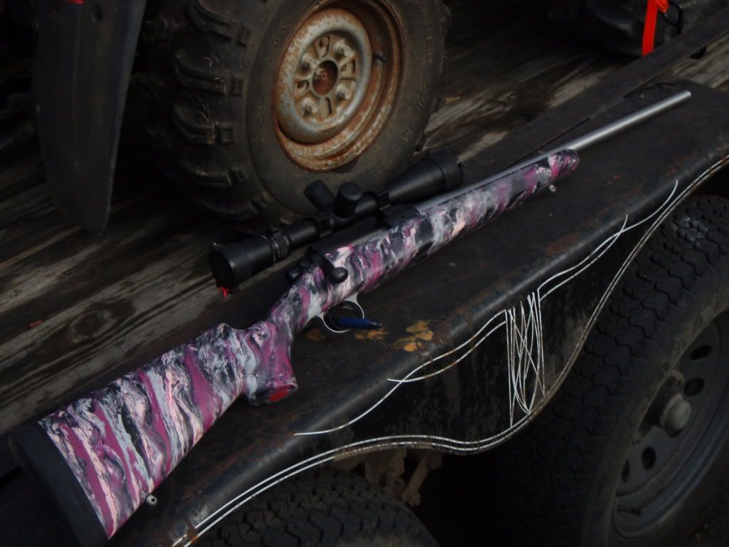

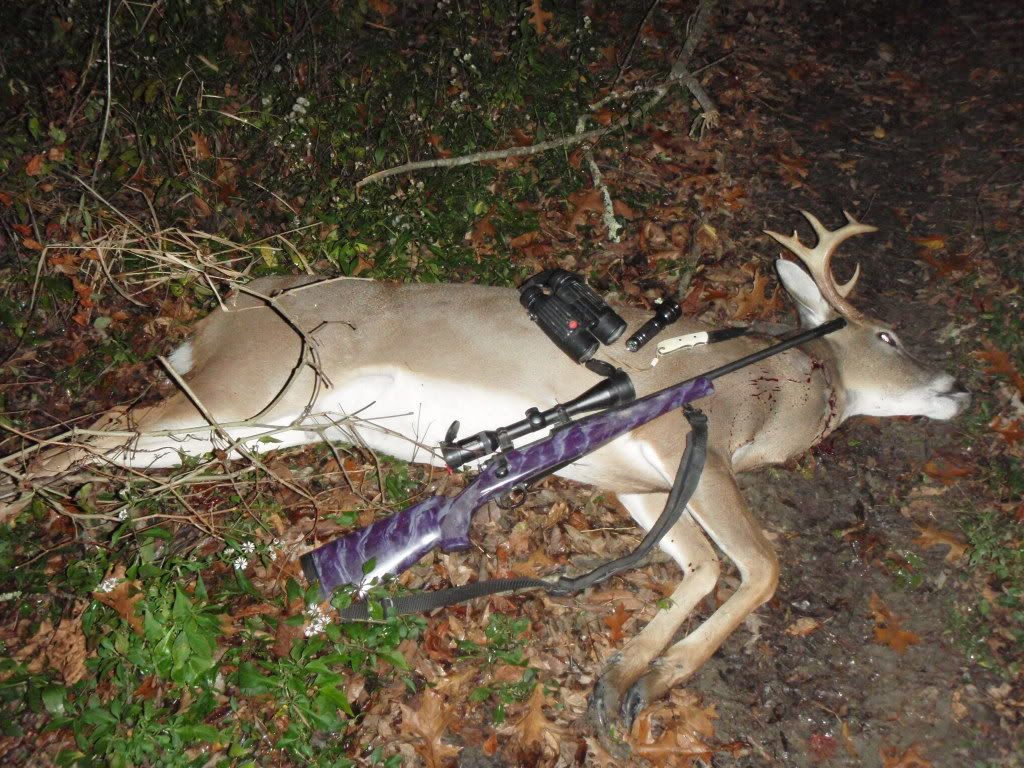

Gotta Model 7 7-08 that shoots the 120 X's,not tsx's)with over 35 1 shot kills on critters....Here's 1
Hopefully the 223ai with the 53's can do this good. Here it is....
