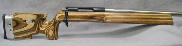

Here's a Barnard in the new Mastin F-Class stock: http://www.websitetoolbox.com/tool/view/mb/file?username=6mmbr&id=86329

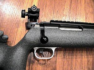

Here's a Barnard in a prone stock, metalwork by Warner Tool:
Mastin Stocks, available from MTGuns, are drop-ins if you get the bedding block deal. Check out Scott Parker's Barnard-Mastin: Gun of the Week 20.

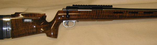

Alex Sitman of MasterClass Stocks has done a number of Barnards.
Gun of the Week #8 features a Barnard in a Masterclass Prone stock.
Barnard in MasterClass Prone
Barnard in MasterClass F-Class
And if your looking for something a little different...Gary Elisio makes tube style stocks for Barnard actions.
