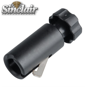

Looks like you need to make a firing pin removal tool. Thats how the over 50 gang does it. Bergara designed their bolts with that hole in the cocking piece and still advertise it to this day. They must have forgotten it on yours. And you also showed just how easy they are to work on- disassemble your savages side by side and make another comparison!
