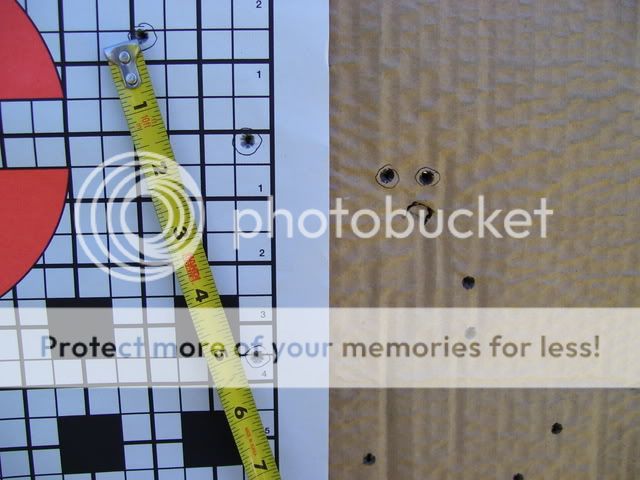

Well, I got the chance to try out the new drop chart that Catshooter so kindly put together for me. Using this G-7 formula is closer to actuality, than my previous drop chart. My last chart used G-1. Here's a quick comparison.
Berger 105 VLD @ 3050fps.
G-7 drop at 975 yards= -18.03
G-1 drop at 975 yards= -23.4
Actual drop 975 yards= -20.75
So I would say thats right in the ballpark. Considering it's 10 degrees hotter, than when the original chart was made.
Oh, here's the group I shot, prone off my fire-control rest.
