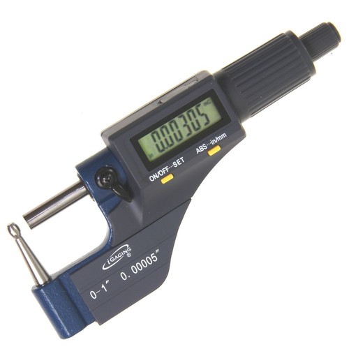

Ball mic or tube mic for measuring case neck thickness when turning necks for BR?
For BR, do you prefer a ball mic or tube mic for measuring case neck thickness to within 0.0001"; which provides the most accurate, precise, consistent measurements? This was discussed some years ago, but perhaps now there is additional sentiment and data.
I think the very best way is to measure a loaded round with a very good micrometer but if I must measure thickness, this is tough to beat imho. It's much less subjective to user input, which is very critical to tubing mics.
Mine came from Sinclair. It is a Starrett on a stand and I don't see how anything could work better. It will also work with .17 cal stuff. I don't even shoot any competition, just seemed the best to me when I bought it probably 5-6 years ago. I don't see any advantage to any shown here.
In my opinion it is costly but works well. At the time I remember it being $150 which took a big chunk out of my SS check! But I am NOT sorry I bought it. Gary
Does yours look like this? If so it's the same one I have and they work great.
