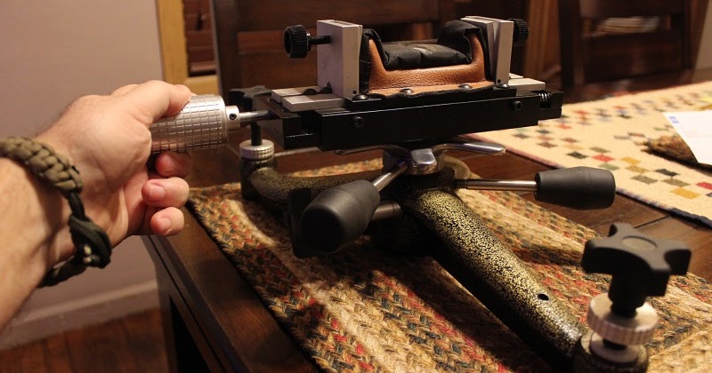

I have a BE aluminum with the windage adjustment, which I did not like, so following what some of the guys at Williamsport showed me, the top can be reversed, the goose neck taken off and the knurled handle mounted directly on the top and it make a 100% improvement.

Question on the Bald Eagle: There appears to be an extra lock on the left side of the main casting - the one with the four arm knob. What is it for?
That one moves the rest top up or down. Coarse height adjustment. (If I'm understanding you correctly.) WD
