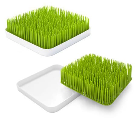

I am another sun-dryer. I live in the California Sierra foothills where daytime highs are 90-100F for months on end. No rain, no clouds. I tumble my decapped rifle brass in a Thumler's Tumbler, rinse several times in clear water, then stick 'em into one of these and put it out in the sun to bake:
Then my brass is, pardon the expression, "fresh as a spring morning"!
