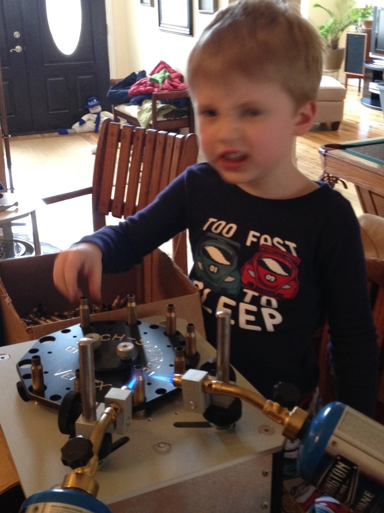

Just went to skips V6 and everything was listed didn't change anything just running lipo battery rather than a power converter.
Motor that is listed runs from 3 to 12 volt. everything was cheap enough and works well. There is a layout of the face plate that someone had posted in the build threads it worked fine.
John
My automatic feeder, runs on PBJs
