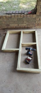

Attempted my first shooting bench
Wolfdog91
Been sick of having to shoot off my tripod due to all the tall grass in the pasture. Personally prefer prone but it's because most benches I've ever used are just no built for people my size ( I'm 5'1" so stuff built/made for average size people usually isn't comfortable or fist me at all) so decided to try and build a myself a shop in bench that fits me :D
More of a welder then a carpenter but after looking at a few pictures taking some measurements of myself sitting came up with this. Ended up having to cut 3" off the bottom because it was too tall but its pretty comfortable now. A bit rusty so my cuts where a bit off .
Would have been nice if I had put the legs on the right way the first time but hay lube and learn lol. Think I'll try and add some wheels to it tomorrow

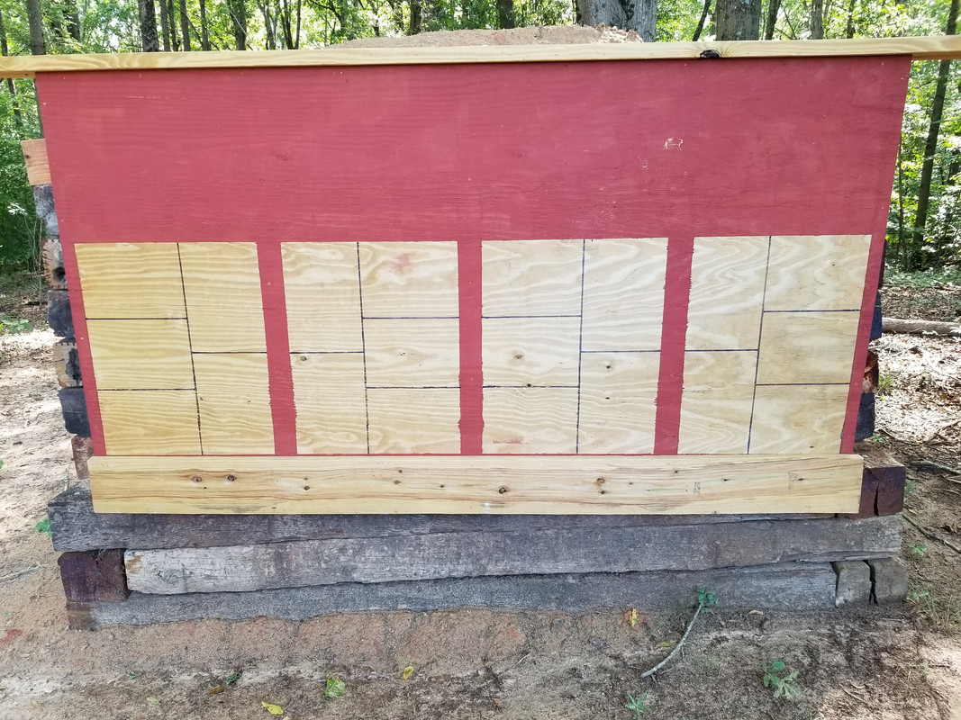

Number of legs Not Important. LOL As long as they are set if 800+ pounds of Concrete. Definitely don't want seat attached to bench. My retirement present to myself. Four years ago, and still solid as a ROCK. Second picture of my backstop. Also, a retirement present to myself. MAN, I love retirement:)
Portable bench (LOL) in last picture. Use a 5-gallon dove hunt bucket for the bench with it. A little heavier than most folks like but it is Solid for sure.
