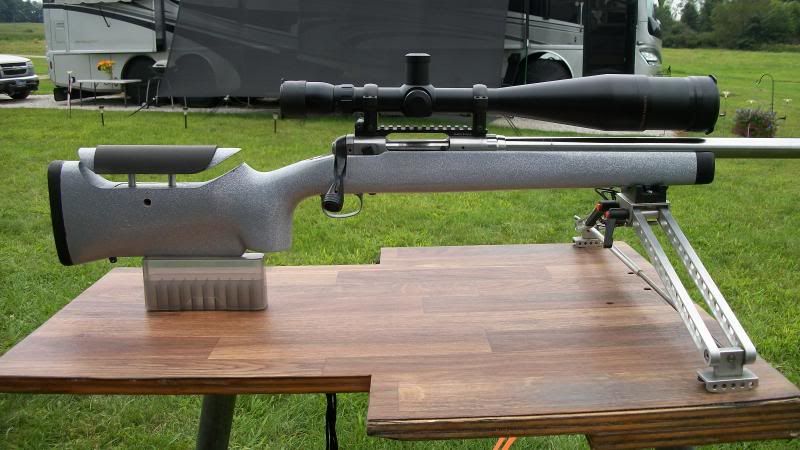

I don't know of one on the market currently... I've seen a few variations out there that were meant to attache to an adjustable buttplate; the design that Nomad shows has the benefit of not raising the center of gravity of the gun quite as much.
I've been thinking about something along those lines myself... might be time to pull out the table saw and make myself a prototype to the size/shape that I have in mind. Thing is, me personally I don't want to get rid of *all* of the taper... just reduce it. I still want a little bit for fine-tuning elevation (F/TR).

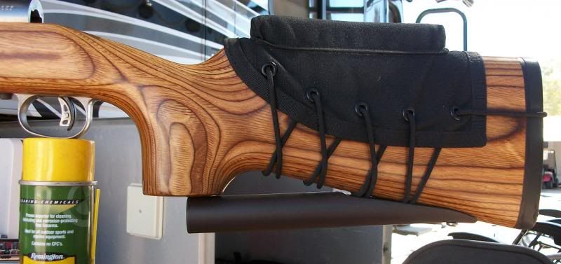

queen_stick, if you are referring to the lace on cheek piece - no, it is not adjustable. I have since removed it and gone with this - which is the same stock and for sale, btw.

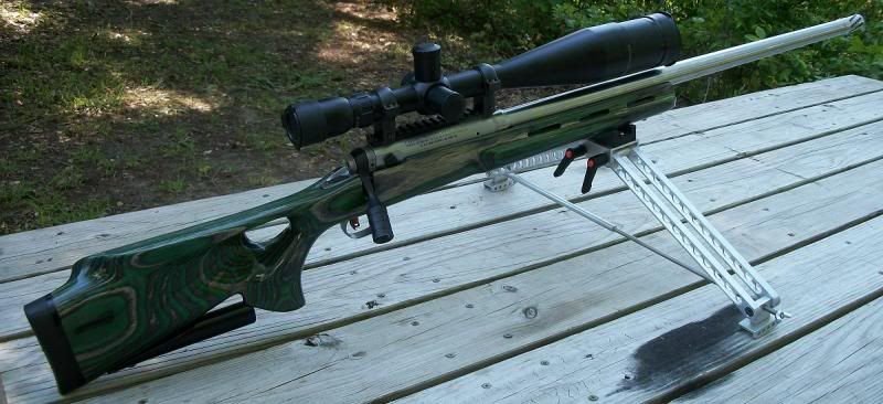

This is my F/tr gun. Any ideas on how to modify this stock? Notice how the bottom of the handle hangs over the bag. I can't get my hand in there to squeeze the bag slightly to make veritcal adjustments. I am seriously thinking about cutting the bottom of the handle off straight with the cut out.

Cutting the handle off will be a last resort thing. Thought about trying to find a piece of aluminum and having a smith cut it to size with a mill and epoxy or screw it to the stock similar to what Nomad did.
Use a smaller bag. Leave the stock as-is.
