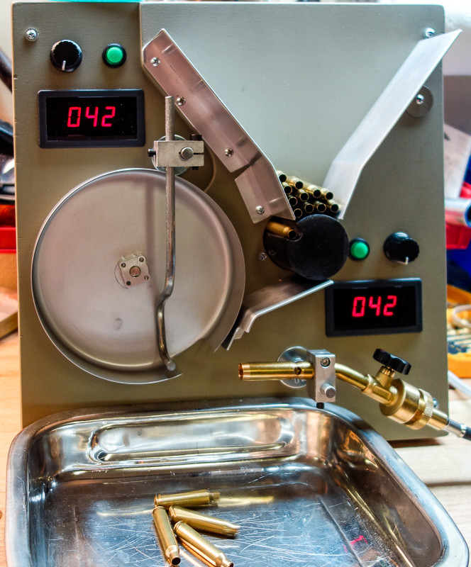

Like many in the UK, I couldn't justify spending a lot of money either, so I built a machine following the now famous "Skip" design. It was inexpensive, quick to build, and I believe it works as well as the best of the case annealing machines and better than some of the commercial products, even some very expensive ones.
Mine is not too large, it's light and easy to store, and easy to operate; fun actually. It's the least difficult step in hand loading and I find that annealing every time is quite convenient for me.
Here's a picture of my machine. Since this photo was taken, I added a proximity switch on the feed ramp to control the feed drum motor so that it stays in sync with the annealing pan motor. I also put in an electronic case counter just for the heck of it.
_DSC3271
