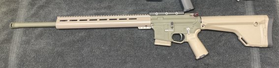

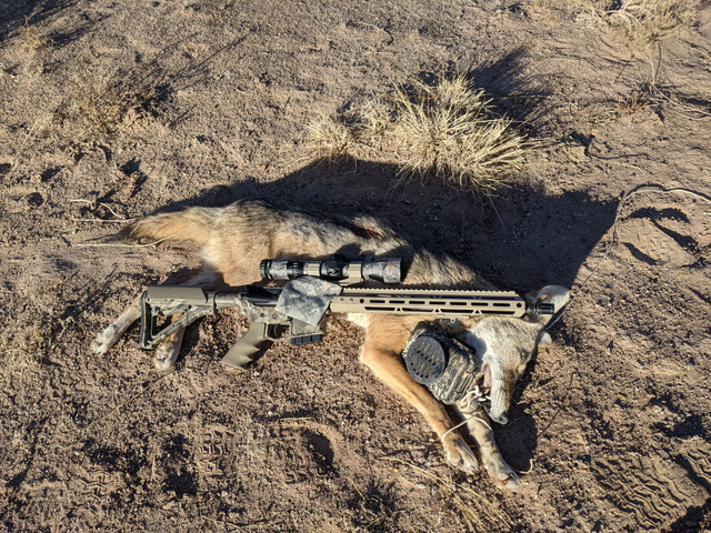

Might as well…. I hunt with a few AR-15s Pretty much gotten off the 223 wagon and went full wildcat. This is one of my favorite varmint rifles for riding fence, got a mile and a half of fence I ride three times a week. The 6mm Mongoose with 80s at 3,000 fps Last yote I shot was at 75 yards, in the pouring rain, kicked twice and DRT. Never exited, just right for a farm. Target is the break in, sight in with 844 Surplus powder.

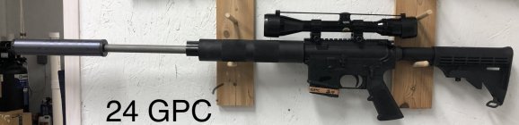

The 24 GPC cartridge name was changed to the 24 Varmint by MDWS, designers of the 24 GPC, to honor Varmint Magazine after the magazine staff did a two year series of tests on the cartridge with positive reports.
