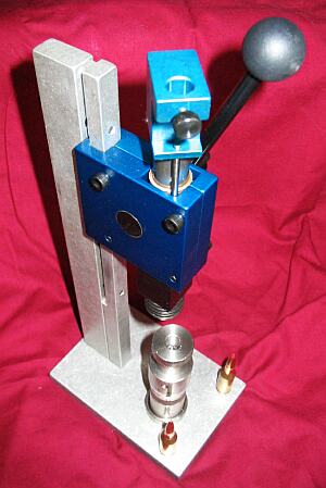

Here's a pic of the K&M. The Dial Caliper would fit in the little light blue fixture at the top:
Note: both these presses have limited leverage. You can't normally use them for FL sizing. They are used for neck-sizing and bullet seating.
