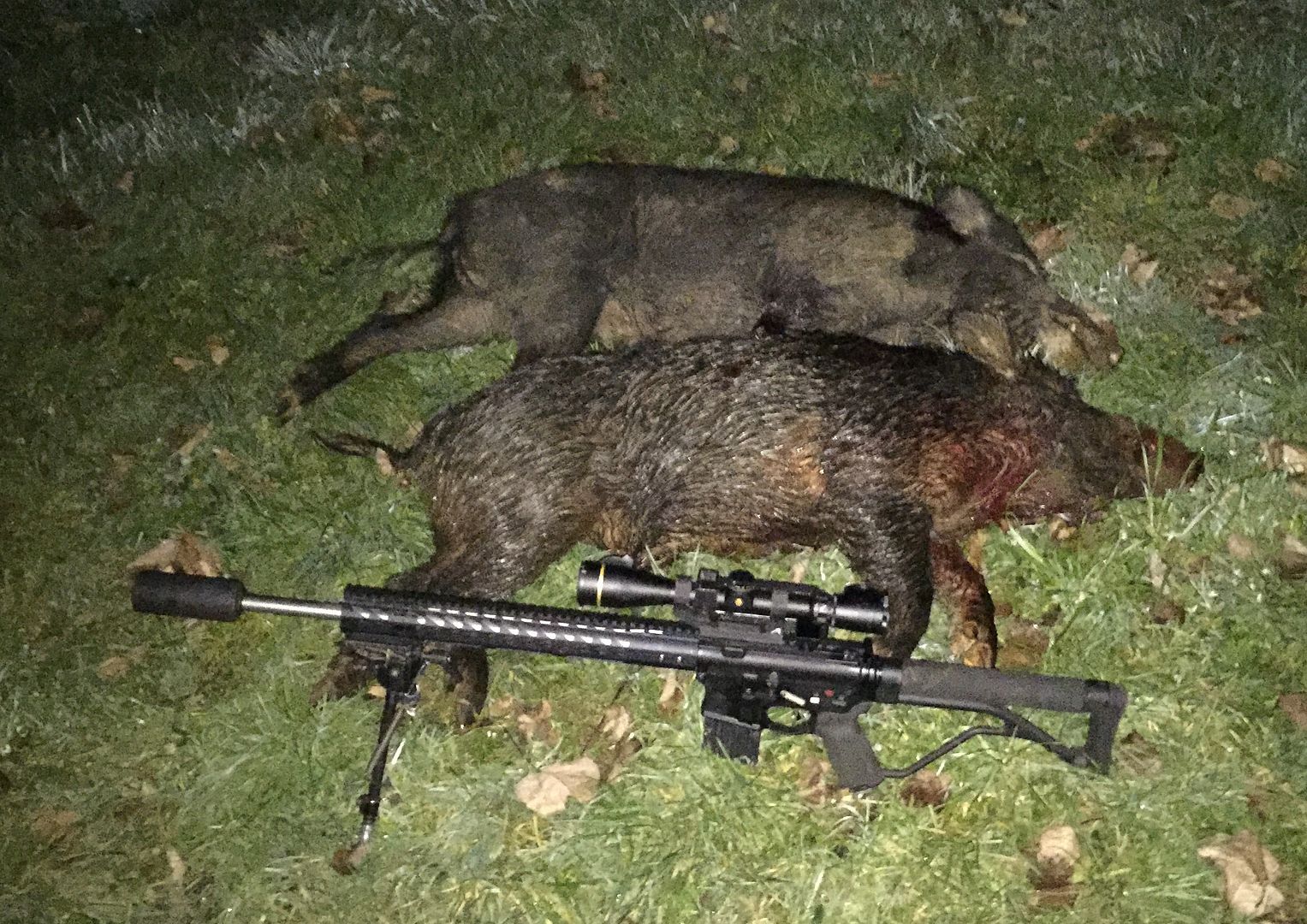

I have a number of AR 15 uppers with the BR case as their base, 338 BRX being the biggest, other than the 450 Bushmaster which shares the same bolt face, they all share the same lower, from 223 to 450BM super & subsonic
They all have 20" barrels & rifle length systems with adjustable gas blocks.
It is possible to overpower the 450 BM bolt so you need to be careful.
Performance is outstanding & makes the 223 performance look exactly like what it is...
338 BRX & a couple of mates :)
