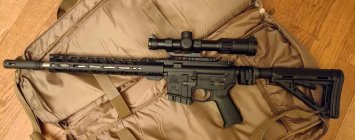

I installed a Gen 3 folder on a 300 AAC rifle. I took it to the range today and was getting misfires about every 5-6 rounds. I had to rerack the slide and was able to fire the round. For those who have installed a folder, is this an issue that is common? Is there anything on the rifle I need to check to make sure the round is going into battery and the firing pin is getting full contact? Thanks.

Just a quick update. Installed the new folder with Sylvan providing what they think I did wrong in installation. Corrected that and the thing runs like a champ. I have an upper in 5.56 that a buddy turned the barrel for from a leftover blank he had. I am quite satisfied.
What was it that they think you did wrong during installation?
I needed to screw their extension in one more turn. It was just enough to get light primer strikes. I stripped it out removing it because the plate was stuck. They sent me a replacement at no cost. Outstanding service.
