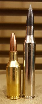

The 6.5PRC is beyond my specs/requirements for a LR-target rifle, especially in recoil (where I'm a wimp!!!!), but I have a positive emotional response to its Short, Fat case.. That love of SF cases started a few years ago with the Winchester 25WSSM.
