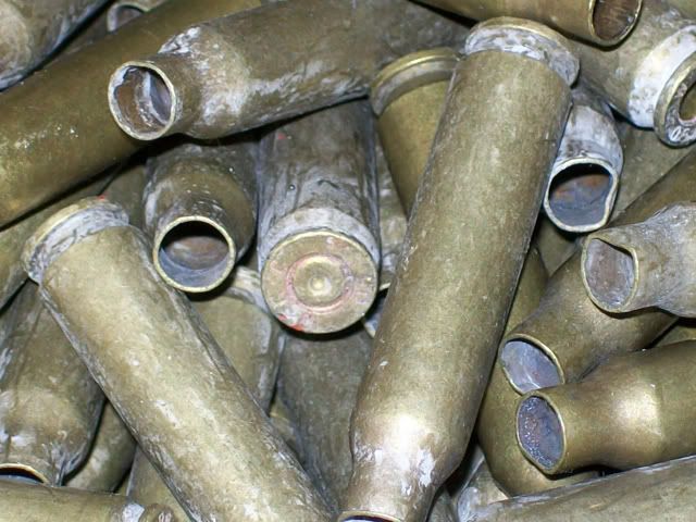

Above post by me is the brass I got. Looks brown. Old shit for sure. Should I use it or buy lake city. Found this link to lake city. DM 45 headstamp is what I got now, not sure how it compares to the Lake City, linked below.

Long story short, should I process my old stock, mostly still unfired DM45 brass, which looks like a turd now. Should I buy some lake city from above website and remove crimps, stakes, etc. or should I just bite the bullet, pun intended, and buy the high dollar Lapua or RWS linked earlier that's $3-5/each. In either case, I have an original Forster case trimmer I'm pretty fond of and will likely buy their 50 BMG case trimmer. I have the RCBS case prep center and could buy the primer crimp removal and uniformer attachments. Just need to know which way to go.

This is the brass I got now. About 200 unfired cases. Is it worth reloading or should I buy new brass.
Looking at this website, looks like mine was made in Des Moines, Iowa in 1945. Looks identical to the two DM45 head stamp pics at bottom of the Des Moines bit.
Scroll down to Des Moines Ordnance Plant. Bottom two images are mine.

"Below is the brass I got. Looks brown. Old shit for sure. Should I use it or buy lake city. Found this link to lake city.

That is good stuff - buy it cleaned for .52 cents each.

"Aside from safety, I'm skeptical about brass prep for this military stuff. Crimped primers, my DM stuff for example has three stakes. Is this a typical 'crimped' 50 BMG primer? I've only heard of crimped primers in relationship to 223, which I just started loading last year. And to avoid that issue, I am using once fired PMC in my high volume Dillon 550 223 loads, and Lapua in my rock Chucker accuracy loads. So I have avoided crimped, staked, etc primers on purpose. "
All military 50-BMG is staked or crimped. Just remove the crimp with a crimp squisher. Don't cut it out

You need to learn how to prepare cases and turn garbage...
... into good cases!
It is a basic talent that every reloader should have.

"Long story short, should I process my old stock, mostly still unfired DM45 brass, which looks like a turd now..."
Yes, learn how to shine poop - it is a necessary art if you shoot mil-surp brass. Every reloader should know how to salvage brass.

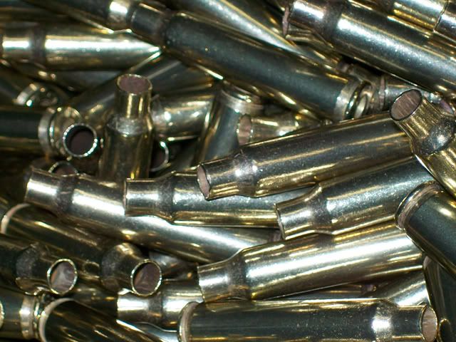

Just bought 360 pieces of 50 BMG Barrett (IMI) once fired cases. They were fired through rifles during training of some sorts. Hot dang, first check mark on the list. Hah.
The guy I bought it from was a cool cat, spoke for about half hour on phone. Lots of top 50 BMG shooters are buying his brass. Notably Lee Rasmussen won the world championship with IMI brass. He also has lots of Lake City 09 I think. Barrett was 80 cent and Lake City was 45 cent. All polished and shipped cheap. If anyone is interested.

Goop pic of brass and additional info here..

Danattherock said:
Just bought 300 Barrett (IMI) once fired through rifle cases. Hot dang, first check mark on the list. Hah.
