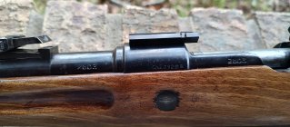

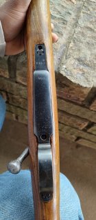

Anyone play with 8mm Mausers ?
Got this little sporter a few months back for like $250 looks like it will be a decent little project rifle,not much in the way of markings though , anyone think they could give me some info on it ? Still need to slug the bore

May be a 1943 Spanish. I have had good luck with 150 Sierras with IMR4895, 160 Barnes and 170 Hornady SST's with CFE223 in a German M98.

Wolfdog91, looks like matching numbers. Do the numbers on the bolt match also? They are great rifles, and the 8x57 is a stout cartridge for hunting at moderate ranges. Do you hunt? They have a lot of whollop for close range on white tails. It’s one of my brothers top choices.

The bolt handle has been re-forged so numbers may be gone Look for number on bolt shroud and maybe bolt release and of course the action. May be a complete match and an excellent find for 250.00.

Thats a Spanish Model 1943 short rifle manufactured at the La Coruna armory. They were manufactured between 1943 and 1957. They are modelled on the German K98 Mauser. Unless scrubbed when sporterized, the receiver ring should have the Spanish coat of arms with the date of manufacture beneath it. My uncle used to hunt boars in the Picos de Europa in Northern Spain with one just like it. Kicked like an angry mule! I'd get a nice recoil pad for it before you shoot it.
Two brief suggestions:
Remove the scope ring base to see if the information is still intact.
Remove the barreled action from the stock to look at the underside of the action. Many countries used this area for proof marks and inspector/acceptance stamps. Sometimes even the side of the rear tang was stamped with some form of identity.
