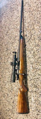

Just finished this 35 WSM. Douglas bbl fluted w/ interrupted flute this was one of my screw ups as I missed an index…oh well, it just went on my own rifle. (thanks Stan for the 1 week turnaround on 6 358 bbls!!!), Win 70 action, McM htg stock with Leupold 2.5-8 mounted. I also loaded ammo for another friend’s 35 Whelen AI last week and PP2000 w/ Sierra 225’s clocked 2740fps 3 grains under max load listed in the Speer manual with resized 30-06 brass.
looks like CFE will be the go to in the WSM case according to QuickLoad.
