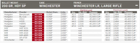

I suggest going to the Hodgdon website for reloading data for both cartridges:
https://www.hodgdonreloading.com/reloading-data-center?rdc=true&type=54
If this link works it should be for all the data for the .358 Win. from Hodgdon. Well, it doesn't help with a data list so you have to select the cartridge then select 'all' of the powders and bullets weights then print it out.
This is what each section will look like:
And this is from Nosler .358 Win.:
