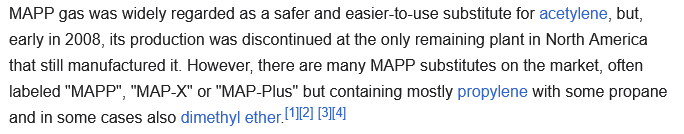

I used (before getting an AMP) Bernzomatic Map Plus gas in my annealing machine. I was able to speed up the dwell time and found that by doing this, the case bodies did not get nearly as hot as when using propane. The slower heating with the propane allowed more heat to migrate down the case before the neck and shoulder got to the optimum temperature. That said, it takes a bit more care to set the flame reach and dwell time just right. I use a dozen old cases to get things set up before annealing any of my good brass.
If my brass had the necks turned, I could run my machine faster with the Map gas. If using unturned necks, and running fast as I did with turned necks, I think the results might not have been as good as the thicker necks were out of the dwell before they heated to the proper temperature. Because I turn almost all brass I shoot, this was not much of an issue for me - just one worth noting for those who don't. A 15 OZ. or so cannister of the Map Plus runs about $15.00 locally, while the same propane runs about $6.00. Since the Map heats considerably faster, the price difference may not be nearly as big as the price may suggest - as the Map will heat more pieces with the same 15 oz., but overall will run a bit more. If taking time savings into consideration - that changes the economics much more in favor of the map gas. If annealing 500 pieces of brass and it saves you 10-15 minutes (2-3 seconds less dwell time per piece) every time you anneal, that may be worth something to those with stretched time resources.
For those of you who do plumbing repairs or re-piping around the house with copper pipe - this Map gas is so much better than propane when sweating fittings. Good to have it around.
