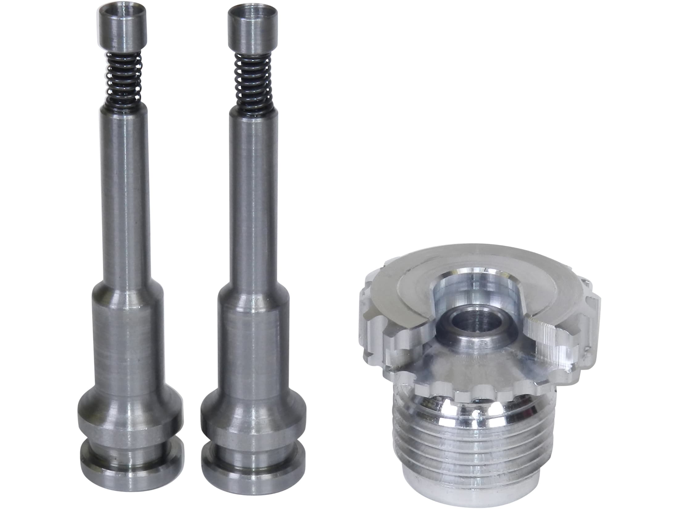

These work very well IMO, but you do have to handle/place each primer into the cup on the tool. Very easy to set up and remove from the press.
