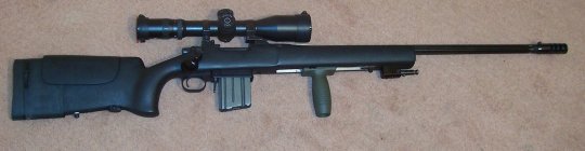

Remington 700 re-barrel and re-chamber project. Removing the .223 Remington Barrel and replacing it with a 1:7 Schinder 6mm chambered in 6mmAR so that I can still use the AR magazine conversion, might give it a nice desert paint job when its finished.
