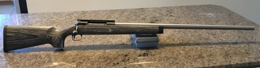

I admire those of us who are pursuing MAXIMUM performance.. They have goals and are willing to pay the prices for the very high performance.. My story is a little different.. I've always been a bit sensitive to high recoil and got moreso a few years ago with a worn-out right shoulder.. In 2007 and '8, after shooting a 16-pound 6.5-284 Shehane in 1000-yd. BR, sometimes very well, usually not so well, and wearing out three barrels, I gave up the entire long-range-shooting hobby.. In 2017 I got back into owning and tuning a similar Savage 12BR rifle, but this was during the time that my shoulder was wearing out and hurt from high recoil.. The original barrel was in 6.54-284, I quickly replaced that with a new barrel in 6.5 Creedmoor, and I quickly replaced that with a 30"er in 6XC.. THAT I could shoot comfortably, but I guess I had consumed all the passion I had for all this and just gave it all up--again. The rifle...
...still stands in my safe.
I can't even conceive of the recoil energy of a BIG .308; I guess that's why I'm now loading for an incoming AR15 in 6mm ARC.. But this almost-77-year-old and new right-shouler joint are doing very well, and I'm really enjoying working up loads for this little 16"-barreled, 6-plus-pound UBR.
