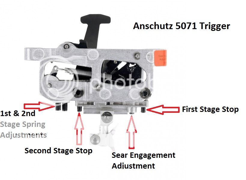

Butch, For the type of shooting you will be doing, the 5018 are hard to beat. they can be adjusted to just under 2-oz in a single stage mode. I setup mines as well as the 5071-1 I use with a small ball bearing; this gives an understanding how light a release they have. the ball bearing is all the surface contact my finger needs to cause release.
Lee
Lee, thanks for the tip. My KK300 has a very tiny cylinder that is adjustable up and down and can be turned in any direction. The more I use it the more I like it.
Lee
I wish there was a good guide on how to adjust the different annie triggers. I have like 6 of various models and i know they do way more than i use them for. Some are 2 stage working as singles but the adjustments arent like id want. A good definitive setup guide would help
