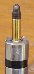

One of the weaknesses of using a spring clip to work as both a retainer and spring for the extractor and holder. check to see if the extractor claw has a big gap above the rim of the fired case, it should be as close to the rim to give tight hold against the bolt face this will determine how much of a kick the ejector will apply to send the case out the port. here is an example of too much gap above the rim.
best fix is hand fit the extractor and holder but as a mass produced rifle not possible

The angle of the extractor also makes a difference as well this why I said best fix is hand fitting them. you want to see them angle inward, towards the center of the bolt face so it is always applying pressure against the case and holder opposite of the extractor.
I bet if you were to take some fired cases and of both thicker and thinner ones and just watch as you cycle the bolt you will see what is going on, you already kind of know the thicker rims eject better.

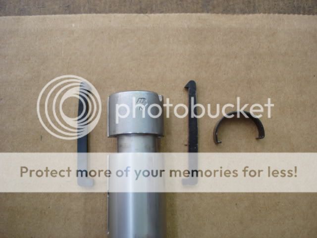

I never worked on a 1700 series rifle but the setup is similar to the Falcon with the spring clip and the Falcon actually uses Savage RF extractors and spring clips. on fitting the extractor you don't touch the front or claw except to clean up rough edges and polish it. the angle is done on the body of the extractor that rides in the slot of the bolt body. you take a extractor and place it in the slot and see if the angle of claw tip is parallel to the bolt face if the angle is parallel to the bolt face you want to make it face slightly in. you can do this by taking a little material off the pivot point to change the profile so it is angled and will cause the extractor to till inward under the spring clip this will cause a downward pressure on the rim and provide a tight grip.
I hope this explains what I mean by angel inward.
