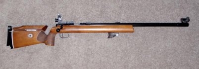

I did add a tuner to it and the stock looked like a well used boat oar so I refinished it with automotive clear. The unpolished aluminum was also a sore spot for me so it was powder coated as well. I knew I was never going to sell it and decided to make it look more appealing to the eye. I'm very pleased with the finished product. I'll put some pics of it on this post later today.

Here are some pictures of the rifle I had questions about. Please note that I did rework the stock and it now has around 4 to 5 coats of automotive clear. I added a Time Precision tuner. All the aluminum has been black powder coated and I have 3" aluminum plate secured to the rail to shoot from one of my rests. I haven't had it out in quite some time, but I did shoot it at 200 yards and it was impressive with Federal Ultra Match. Believe it or not it also liked the cheap Federal Auto Match at that distance.

Outstanding. That looks like one of the older Leupold BR scopes? The quality of their AO thread, glass, and finish were excellent.
Mark
Very nice - thanks for sharing the pics, Attrum. The tuner will give you added flexibility as far as what ammo the rifle likes and what it doesn't like. I use Eley Edge with my model 1600 for 200yd competitions. You'll have to experiment to see what works for you (part of the "fun" of shooting smallbore rifles, I suppose :D...).
